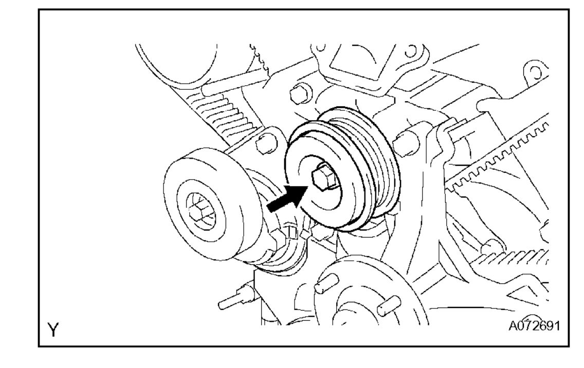

8. REMOVE FAN AND GENERATOR V BELT
imagen1

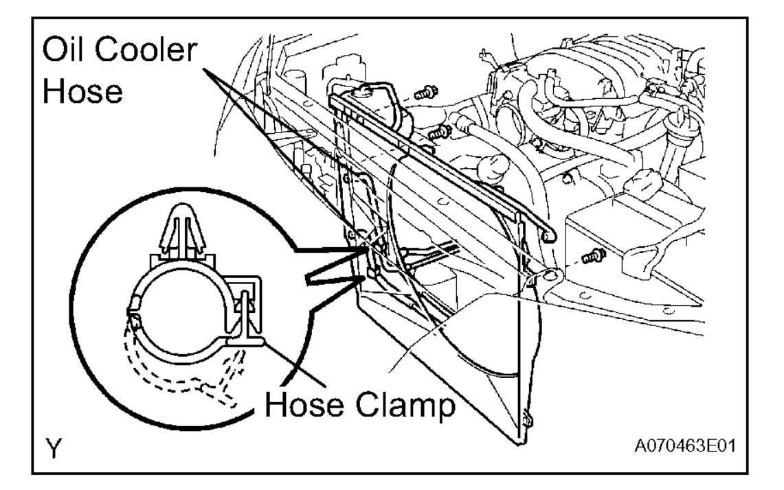

9. REMOVE FAN WITH FLUID COUPLING
(a) Unfasten each clip and the 2 hose clamps, and then separate the 2 oil cooler hoses from the fan shroud.
(b) Remove the 3 bolts and separate the fan shroud from the radiator.
(c) Remove the 4 nuts and separate the fan with fluid coupling from the engine.
(d) Remove the fan shroud and fan with fluid coupling together from the vehicle.
(e) Remove the fan pulley.
imagen2

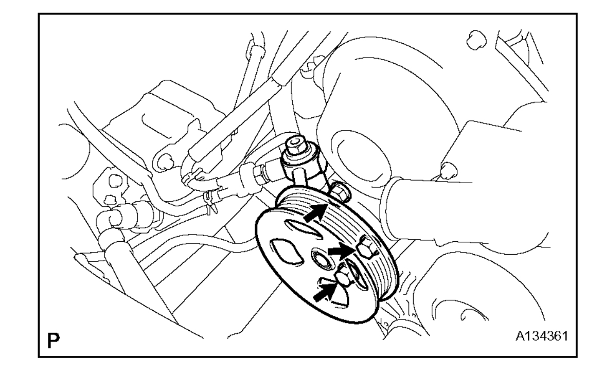

10. SEPARATE VANE PUMP ASSEMBLY
(a) Disconnect the vacuum hose.
(b) Remove the nut, 2 bolts and vane pump assembly.
HINT: Hang up the hoses instead of detaching.

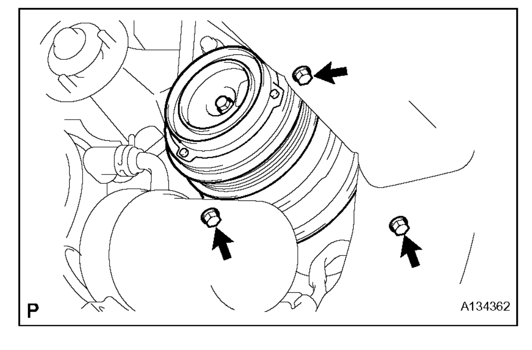

12. SEPARATE COMPRESSOR
(a) Disconnect the compressor connector.
(b) Remove the nut, 3 bolts, compressor stay and compressor.

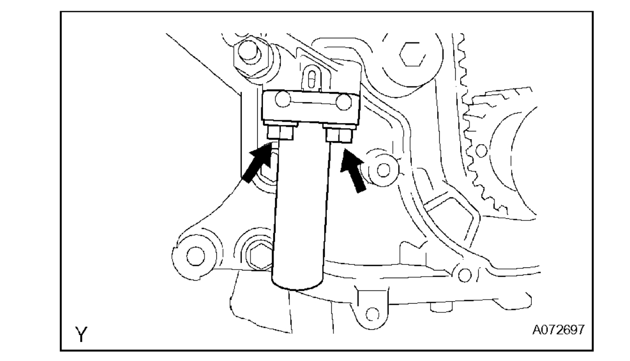

14. REMOVE OIL COOLER PIPE
(a) Disconnect the 3 hoses.
(b) Remove the bolt, nut and oil cooler pipe.

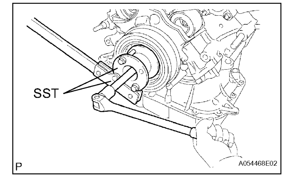

20. REMOVE CRANKSHAFT DAMPER SUB-ASSEMBLY
imagen6
(a) Using SST, remove the pulley bolt.
SST 09213-70011 (09213-70020), 09330-00021

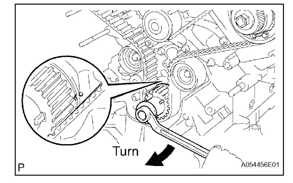

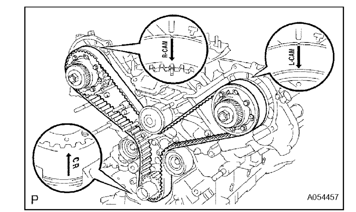

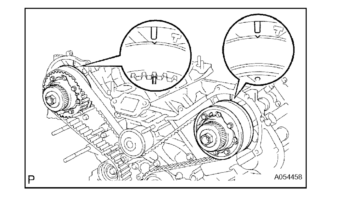

23. REMOVE TIMING BELT
imagen10
(a) If reusing the timing belt, check the installation marks on the timing belt.
(1) Check that there are 3 installation marks on the timing belt by turning the crankshaft as shown in the illustration.
If the installation marks have disappeared, put a new installation mark on the timing belt before removing each part.
(b) Set the No. 1 cylinder to approximately 50 BTDC/compression.
imagen11
imagen6

imagen10
imagen11
