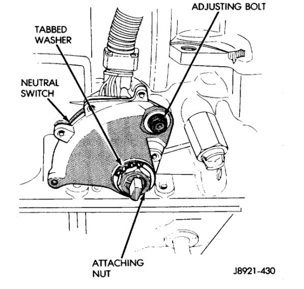

REMOVER
1. Raise vehicle.

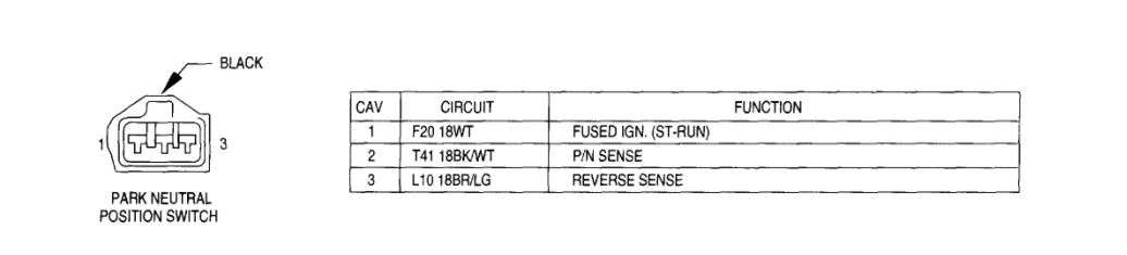

2. Disconnect switch wire harness connector.
Park/Neutral Position Switch Removal/Installation
imageOpen In New TabZoom/Print
3. Pry washer lock tabs upward and remove switch attaching nut and tabbed washer.
4. Remove switch adjusting bolt.
5. Slide switch off manual valve shaft.

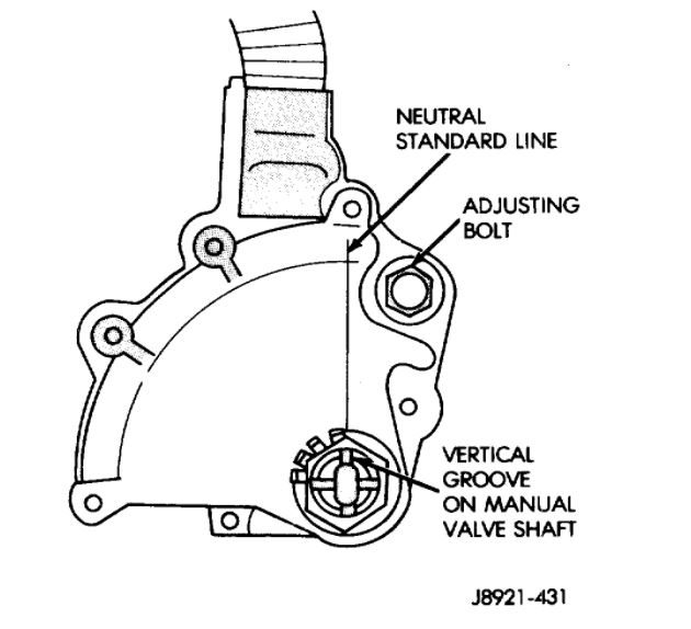

Park/Neutral Position Switch Adjustment
5. Verify that transmission is in Neutral.
6. Rotate switch to align neutral standard line with vertical groove on manual valve shaft.
7. Align switch standard line with groove or flat on manual valve shaft.
8. Tighten switch adjusting bolt to 13 Nm (9 ft. Lbs.) Torque.
9. Bend at least two washer lock tabs over switch attaching nut to secure it.
10. Connect shift linkage rod to shift lever on left side of case.
11. Connect switch wires to harness and lower vehicle.
12. Check switch operation. Engine should start in Park and Neutral only.
