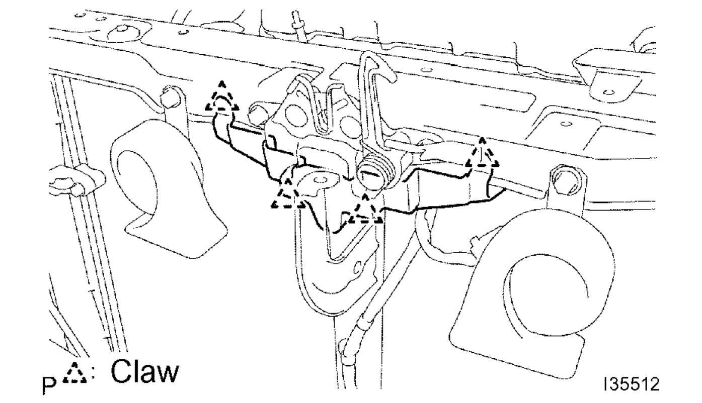

13. REMOVE HOOD LOCK RELEASE LEVER PROTECTOR
a. Release the 4 claws and remove the hood lock release lever protector.

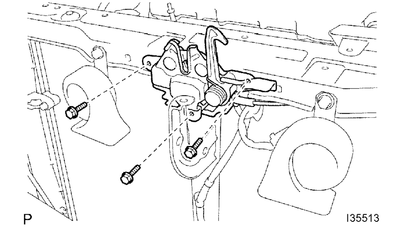

14. REMOVE HOOD LOCK ASSEMBLY
a. Remove the 3 bolts and separate hood lock.

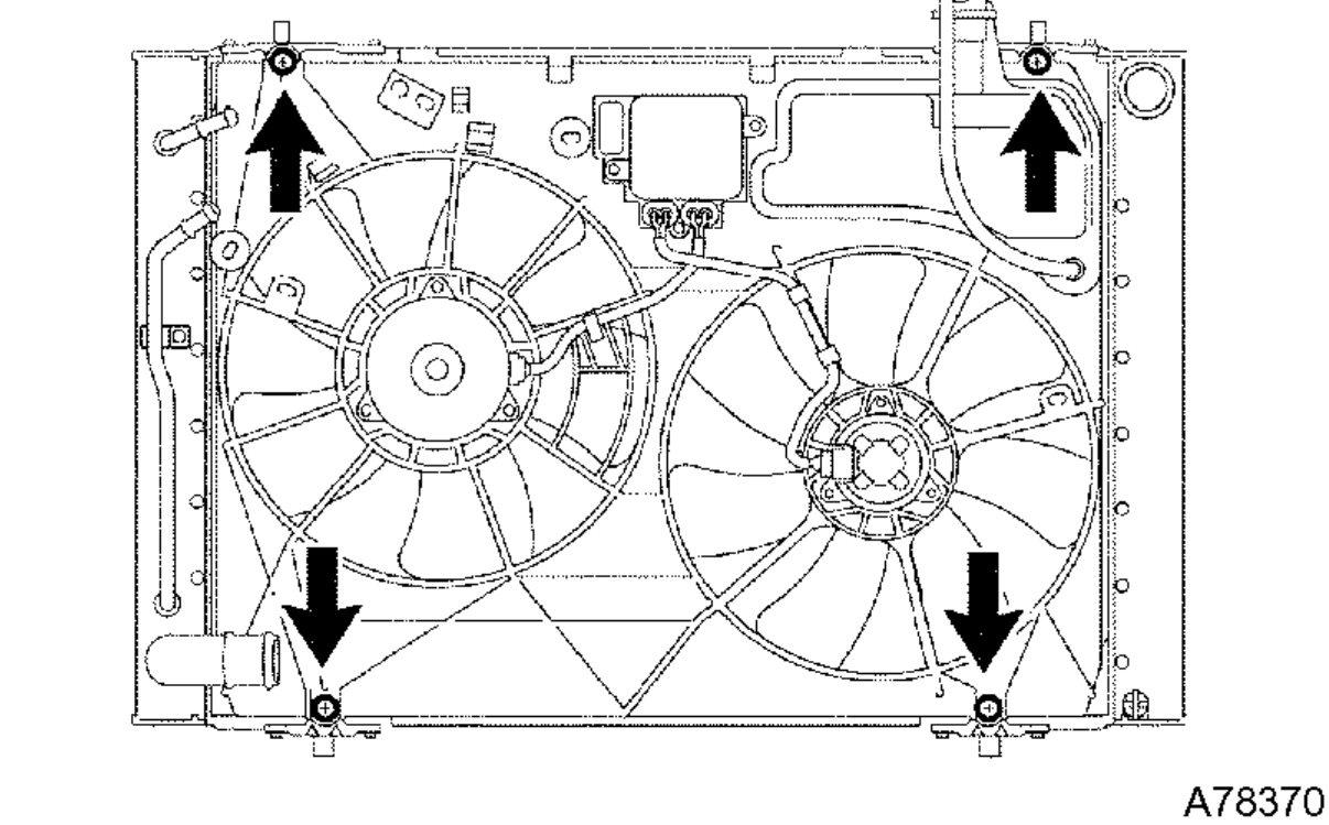

16. REMOVE FAN SHROUD
a. Disconnect the engine coolant reservoir hose.
b. Disconnect the fan motor connector.
c. Remove the 4 bolts and the fan shroud.

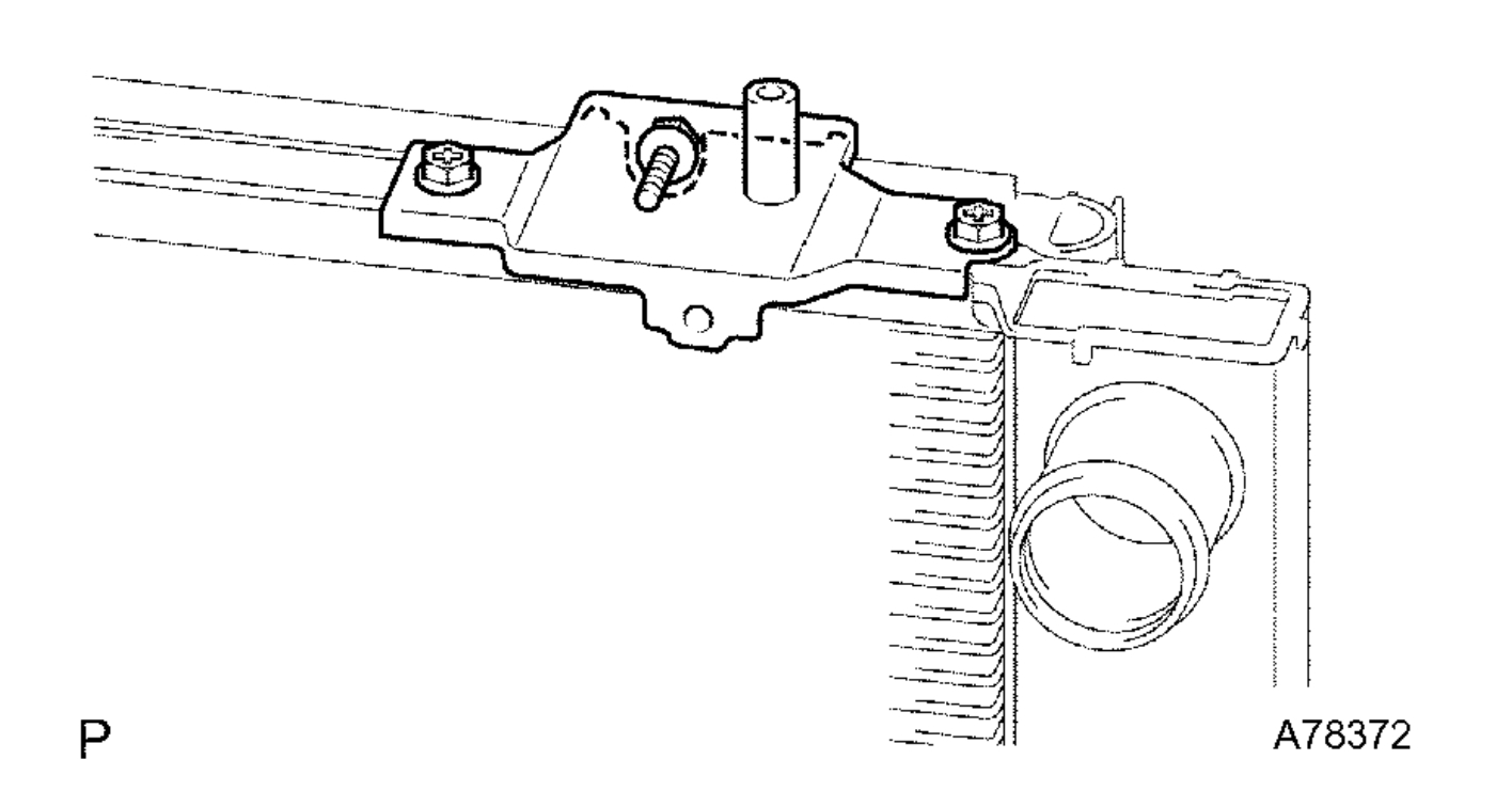

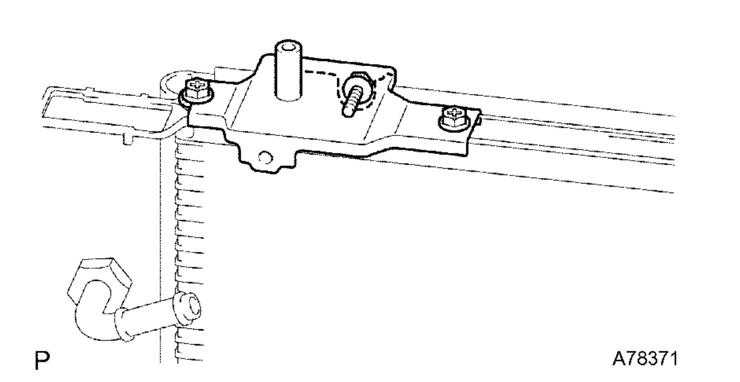

17. REMOVE RADIATOR SUPPORT SUB-ASSEMBLY UPPER LH
a. Remove the 3 bolts and the radiator support upper LH.
18. REMOVE RADIATOR SUPPORT SUB-ASSEMBLY UPPER RH
a. Remove the 3 bolts and the radiator support upper RH.

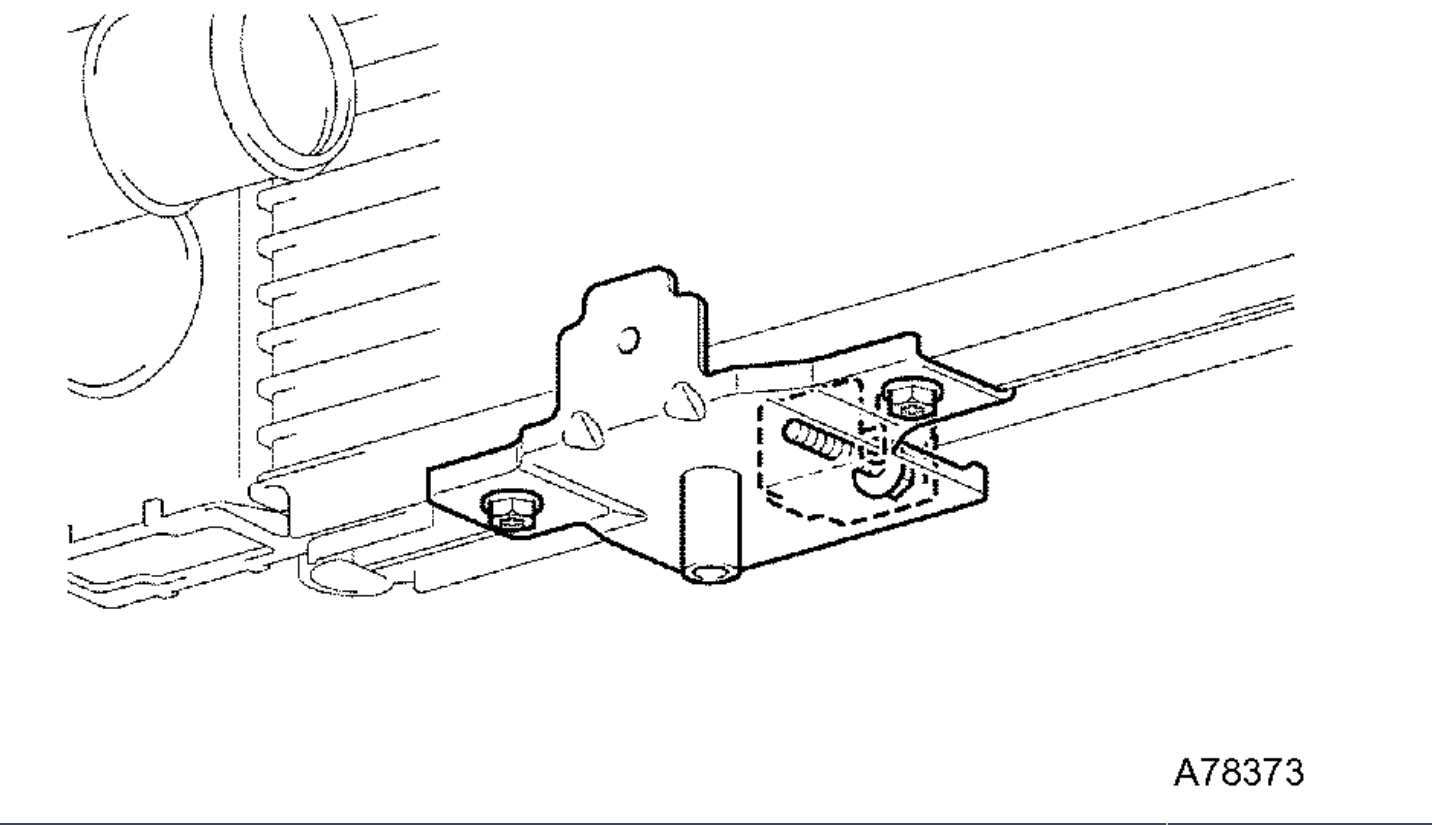

19. REMOVE RADIATOR SUPPORT SUB-ASSEMBLY LOWER RH
a. Remove the 3 bolts and the radiator support lower LH.
20. REMOVE RADIATOR SUPPORT SUB-ASSEMBLY LOWER RH
a. Remove the 3 bolts and the radiator support lower RH.

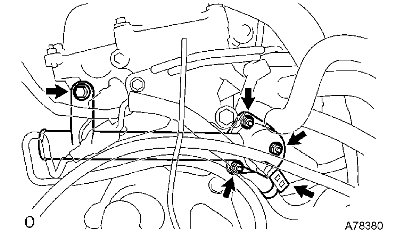

10. DISCONNECT RADIATOR HOSE OUTLET
11. REMOVE WATER INLET
a. Disconnect the wire harness clamp.
b. Remove the bolts, the 3 nuts and the water inlet.

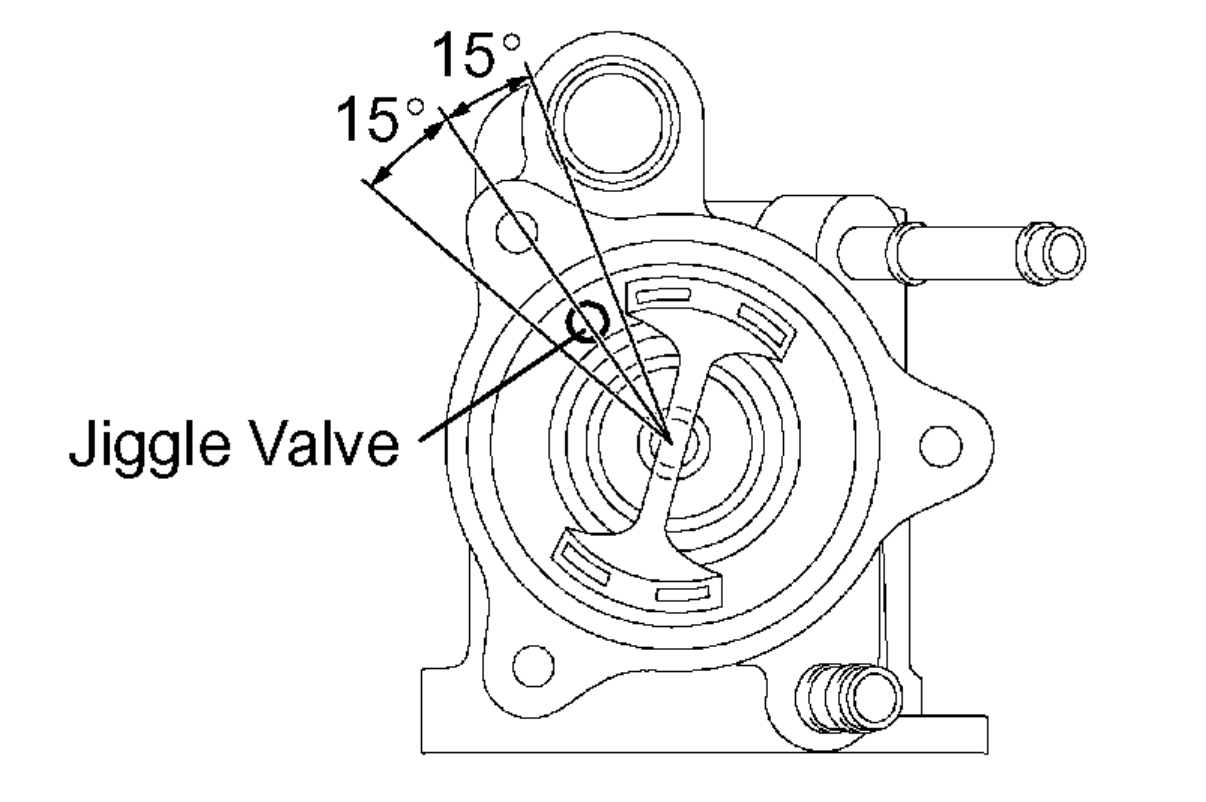

12. REMOVE THERMOSTAT
